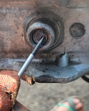

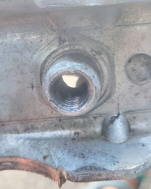

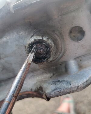

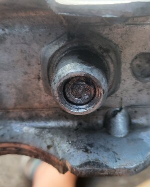

It's out!! 🥳
The handle was quite loose in the 'nut' and generally turned ok, but a section round would go really stiff.
Initially I started to screw it in, thinking it would come out the other side, but it went really tight and wouldn't budge and I worried that it may be a hole/nut with a stop on it, preventing this, so did undoing instread.
I managed to drill a small indent into the bolt and use mini screwdrivers to spin the bolt around to undo it.

Great news, don’t forget some anti seize grease on the new one, I would have said Copper Slip Grease but I know someone would chip in that it’s abrasive!
Great news all the same and well done.
