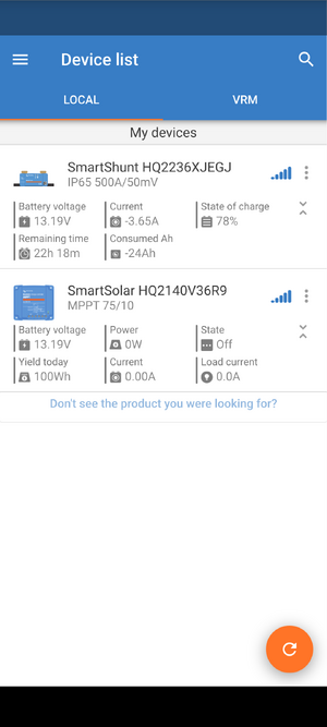

Just be careful not to run the battery down too far. I have some decent monitoring equipment on my system so know exactly how discharged the battery is at any moment in time, so I can sail close to the wind with it all.
At present:
