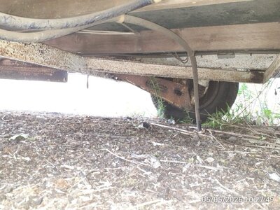

Yes i have checked both sides - jacked her up and took off the rims. As she is on blocks i checked the length of the chassis. The only solution i can think off is getting the suspension off - taking measurements and contacting Premier Towing Centre, Birmingham. They seemed helpful last week but said i should try and find the ETI number.

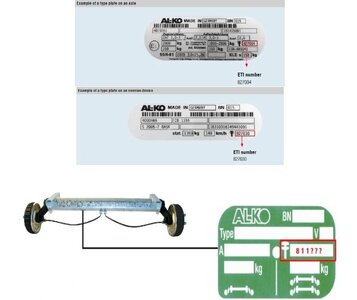

Also try trailer tek ,HK Trailers and Towing centre, taking photos of the hubs inc dimensions inner diameter and width of hub ,and brake assembly on the brake plate together with the diameter of the stub axle and if the hub has taper roller bearings or sealed for life ball bearings .When you say you've checked the chassis have you checked along the axle itself?

Thank you for that illustration. I haven't got the axle from one side to the other - just stub axle each side. Next w/e i will have to get them off and take measurements. It would seem it's not ALKO-ETI and someone else. Think i have got some nightmare research to do.

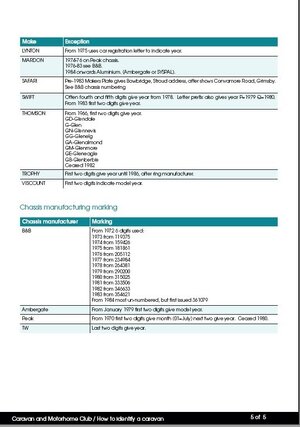

Alko took over B&B trailers in 1982 so if your Caravan is definitely 1981,you have one of the last chassis by B&B trailers, Our first Caravan in 1973 was on a B& B chassis which were Black Painted Steel ,not Galvanised,

My VIN is X81/1409... no idea how many they sold in a year if mine is 1409 - can only guess one of the last ones. Yes the chassis is steel not galv. Thanks for your post - i am knew to caravans so no history knowledge.

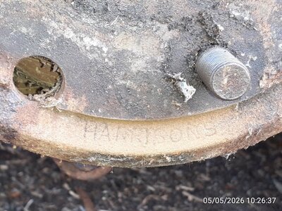

I've looked at the bearing hub caps - no B&B but there is 'Harrisons' on the bearing hub caps and brake drum. Could it have been that mine was one of the last ones and after B&B they turned to Harrisons?

A Google AI search indicates that CI built their own chassis for Sprite and their other brands but put proprietry components on like brakes, stub axles and hitch coupling - Harrison Steel was a in-house subsidiary of CI.

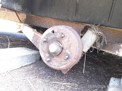

I'll just have to get them off and take measurements. But had a problem - can't see a locating screw or bolt for the drum so can't see how to take it off.

50 years since I serviced mine but from memory the drum just pulled off the wheel studs once wheel was removed. Looks as though yours will be held on tight with rust around the studs. Give a good soak around the studs and centre hub,with penetrating oil before using a soft hammer to knock drums off
I was expecting to find a screw to hold the drums on like Series Landrover and similar. I haven't been able to try oil and soft hammer therapy this morning. Thing that worries me is that the drum backplate is close to the edge of the drum so no space to tap the drum from behind. I shall investigate next week when i am back from work.
If you give it a good soaking with penetrating oil and leave a couple of days and then turn the drum and tap it around the circumference with soft hammer, it may well loosen it enough to pull off, Did this with Morris Minor drum brakes back in the 60’s
