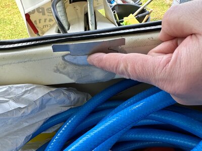

Strange part fell off inside front Swift locker

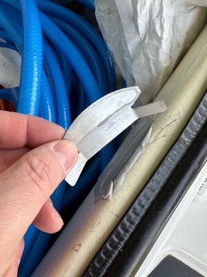

Part was at the bottom centre and as it accidentally pushed it while placing in the hose, it fell off. Seems a bit of a bosh job to stick it on in the first place

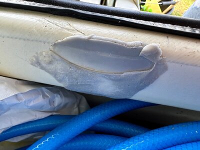

Does everyone’s else’s locker have this, does yours looks the same at the back (like hard putty), and what is it used for?
Looks like an epoxy putty but the grey overspill is strange as you wouldn’t normally expect overspill. Might be caravan sealant/adhesive poorly applied. the scratch marks in the beige surround seem to indicate something has created them with force. . No idea what it was intended for but the method of fixing is suspect in relation to its durability and functionality. If it left the factory like that whoever is responsible for signing off that area of the caravan needs a good talking to. Conversely the dealers PDI is questionable.
Is it in the area where the locker catches engage behind the panel? Mine has two catches at each end and they actually engage on the fibreglass itself which is daft as it could wear the surface away over time.
Our 2019 Swift has a central locking handle that connects to 2 rods that then move when the handle is turned, and 'lock' either end . nothing in the middle, as in the picture, was this a new caravan or new to you, IMO somebody has added the putty and plate at some time but can't understand why
It’s a 2023 brand new from the dealer in Oct of last year.
Going to ask about it when we are back at the dealership having snags fixed
It’s at the bottom centre when you open the front locker, no idea what it’s used for, could be to stop the locker door pushing right back into the locker?
Given the scrapes on the fibreglass surround and on the steel plate itself we might assume it is a central guide for part of the lock mechanism - but certainly the epoxy has been clumsily and ineffectively applied! If there is a similar van on the forecourt ask to view that to see if yours is a one/off then get the dealer to solve it!
Good idea, will check it out when we are there
Our 2024 challenger is 10 week old and the same has happened to ours! Bad design - needs a recall. I would suggest a larger plate and riveting in
It may be bad design, but I doubt it compromises the safety of users or the mechanical integrity of the caravan, so it is not recall worthy. More likely a technical action on service instruction for dealers to look out for and correct at a service.
Saxo Appeal,
As of 4 days ago yours is not a one-off! Now we’re back home I’ll be looking at bonding ours back in place later today.
Mick
Dealership has agreed it should have been delivered from factory like that
As mentioned earlier, the plate needs riveting or screwed in
Getting fixed when it goes in next month 🙂
I'll just resurrect this thread to say that I used a thin smear of Araldite to reattach the plate to my 'van and it's stayed in place through this past weekend's use. The wear marks on the plate suggest it prevents the central part of the lock mechanism from contacting the plastic front of the caravan.
