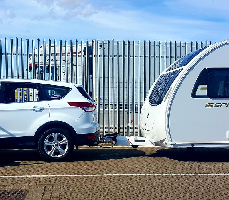

Oct 12, 2013
3,037
This was car and van fully loaded for the 4 of us for 2 weeks last year on route to Holland . Car suspension barely budged !
What’s that got to do with the quote? Your point is?
Oct 12, 2013
3,037
Didn't realise I had put a quote in with the picture sorry ! But point was no chance of grounding out !

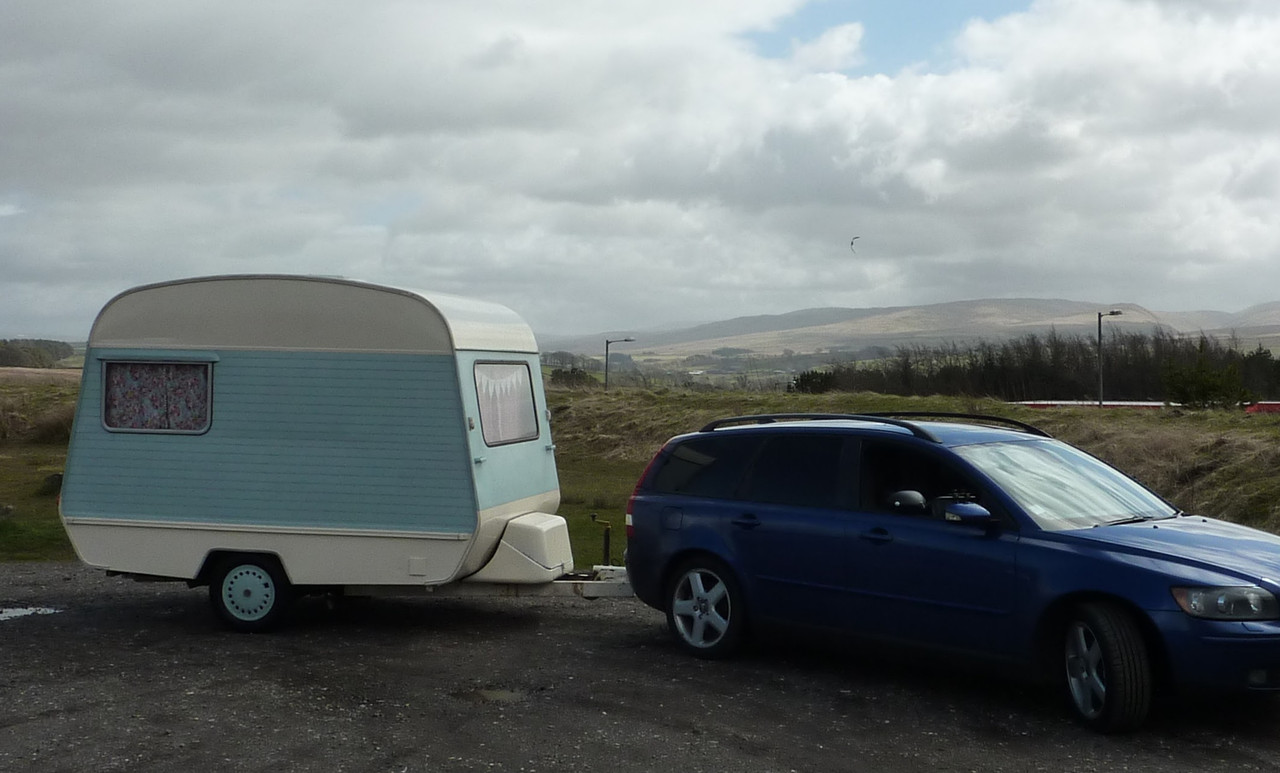

Regarding the perceived aerodynamic benefits of the SUV... here is a pic of my Cadet and V50 at Tebay Services. You can see how upright the front of the van is and how comparatively low the back end of the car is.
12,048
4,221
Yes the outfit is unstable , but easy for me to get into. BTW Craig. :p
