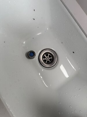

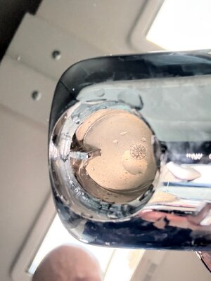

Hi folks
When I was trying to flow the water through the bathroom tap while pitching up, the spout popped off and what looked like filings came through
I’ve tried pushing it back up and turning it but it’s not working and pops right back off when pressure of the water is flowing through, so there must be a technique to it for fitting?
Before I go break something, has someone had this happen and fixed it?

Sorry don’t have the answer except most spouts are unscrewable so that debris can regularly be removed from the filters of which the blue grid shown is a part. Does the spout in the photos unscrew into two parts? I recall others fitting a suitably sized domestic tap replacement as a much cheaper option that a specific caravan tap if yours cannot be reassembled - assuming your relies on a pressure activation and not micro switches.

This is a common issue on Swift taps. They seem to have a contractual obligation to pop off. First of all dry the tap end and the popped off filter. Then look for the notch and the corresponding dovetail bit on the tap and filter and line them up. Press together really really really hard, don’t try and twist.
In the majority of cases this has done the job provided you are steady when turning the tap on.
This is well reported on Swift owners group on FB and worked for us

Thanks Mel, will try pushing it hard in tomorrow morning and see if it works, good to know it’s a known issue.
I actually thought (and tried) pushed upwards then turned to lock it into place, but this don’t work 🤦

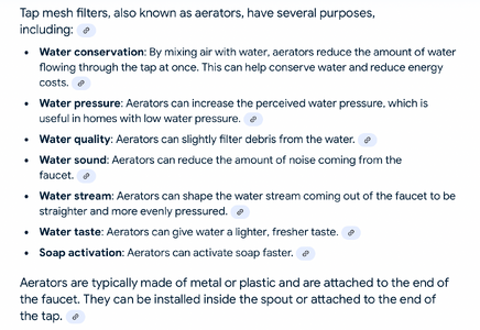

I struggle with the idea and purpose of spout mesh filters in order to trap debris within the system.
A mesh filter prior to the pump should be sufficient.
The mesh filters are also aimed at giving a smoother, quieter conformal flow with less splashing. . Which enhances your user experience. As you have now discovered. 😂

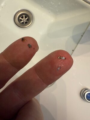

Going to contact our dealership again and have this sorted under warranty if it keeps popping off.
What’s worrying me, is I’m hoping this ‘flake debris’ which followed when the spout popped off, isn’t something which came from the hot water tank…seems odd as there shouldn’t be anything in the pipes bar water.

Unfortunately whilst the water may be clinically safe to drink, you might be amazed at waht can collect in heaters. The bulk is limescale, which can have some quite mixed up colours from reacting with minerals in the local water, and with material from inside the pipe work of appliances.

To follow on regarding the limescale, in June we bought a new Swiss 1000w kettle and used it for about 3 weeks. It was used in Somerset, 1 week, S Devon 1 week and 5 days in Dorset. Yesterday on checking it we were quite amazed to see a significant build up of lime scale on the bottom of the kettle.
On checking our kettle at home cannot see any limescale build up and that is being used a couple of times every day. The kettle at home has been in use every day for the past 2 months!

Spot on Mel, I lined up the spout with the tap as you said, and gave it a real big press. The spout which fell off pushed up inwards, then the front part pushed up further and at an angle.
Looked good so I turned on the tap, the water is now directed properly to the middle of the sink and stays on even with a fully open tap cold or hot.
Thank you so much for the help, and others (y)
And yet none of our home taps have one.
There are other advantages. Perhaps perceived.

I've never really given this much thought to this before, but it totally illogical to put a "filter" inside a tap down stream of the actual valve. What would the "filter" be filtering? The place for a filter is on the input side of the caravan not the outputs.
So what are these mesh inserts for. Well there are tow possibilities which have already been mention, one is even out the flow of water, especially in a mixer tap where you really want the water to be evenly mixed.
And in some later taps it may well form part of an aeration system which is for water saving.
