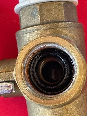

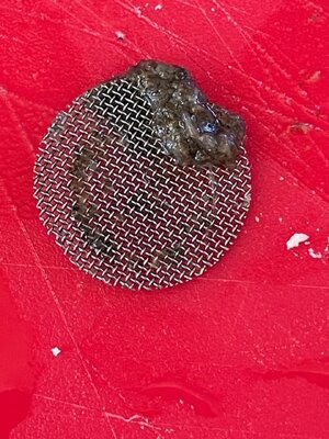

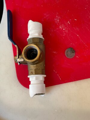

Well well . Bought a new pump, At Leominster. Very lucky. Removed both 3 way valves . And there was the problem. Both contain micro mesh filters . All blocked up. All cleaned , installed new pump, old one is 15 yrs old. Brilliant we have running water again , a spare pump and a new spare 3 way valve. Thanks to everyone for all the advice. When it happens on site you feel isolated!

Here’s some photos. No Wi-Fi where we are
18,437
4,257
I thought my Puriclean and Milton would have stopped the sludge build up. 😢😢
It’s so clean now. Steve even you will be safe.
Back to all the offers of very constructive help thank you . No Wi-Fi didn’t help. I made the Classic error yesterday afternoon of jumping to conclusions. As Hutch knows any caravan issue needs to be investigated inch by inch from in my case the Aquaroll. After a good nights sleep sensible diagnostics worked.

Both the products you list will kill algae and help to render the system clean enough to take potable water and to some extent it will un anchor algae from its foot hold in the pipes, but it doesn't magically make the sludge disappear. The sludge will be a combination of the algae's remains, and any impurities, like lime scale, dust and detritus that's in the water from the tap or water container.
