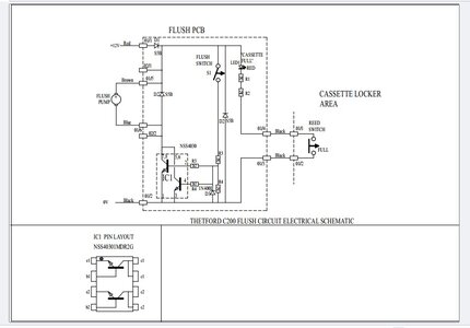

The flush switch is transistor assisted ,so the switch doesn't take the pumps current, it wouldn't take much of a contamination to trigger the dual transistor IC.The pcb may have got water on the tracks,or around the switch ,particularly as you say it comes on randomly . See attached schematic. The first thing to do is wash the pcb in clean water , distilled if you can get in. A toothbrush can be used to help remove any white deposits ( which is a sure sign of water damage). a final wash with Iso propyl alcohol. rebuild and a quick spray of silicone spray will help keep the water from
