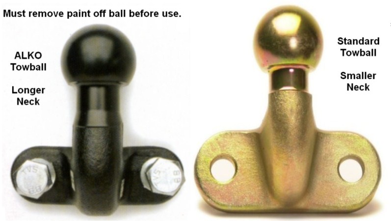

Is your pickup towball compatible with the caravans Alko hitch. The Alko compatible towball allows more movement of the caravans hitch. Most outlets or towbar fitters can supply a Alko compatible towball.

Hello Pond, here is a picture to show the difference between the two types.

No need to send us a picture-simply get the tapemeasure out and check out the dimensions in this pdf. If it is Nissan Navara-recent, ours is most def Alko compatible;

If it is a swan-neck or detachable towball (i.e, has no visible flange like above pictures) it should be ok with an AL-KO stabiliser hitch.

Sorry not sure-just make sure they are tight! If it is a Navara it won't be swan neck- the suspension and ball position is high enough as is, but like the photo-the black not the gold one-just check the height of the ball ie length of neck-ours is fine!
