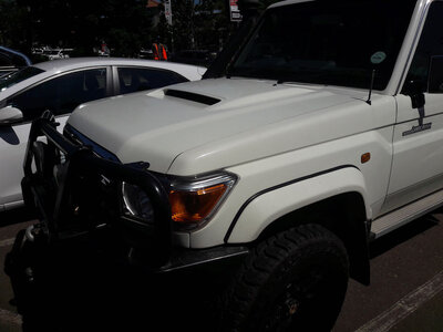

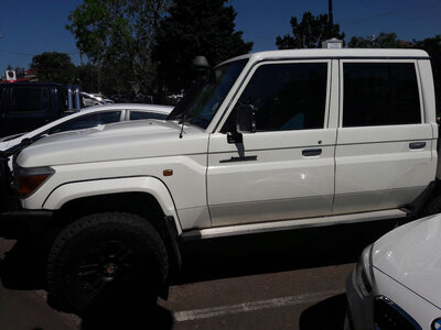

Probably why the Landcruiser is selling so well with apparently a 2 year waiting list?
Have you seen the pictures and reviews of the new Landcruiser. Reverted back to its “boxy” style and with a range of powertrain options. Looks designed to take on the Defender off road too. Check out Autoexpress website if interested.
16,747
5,403
Have you seen the sits and reviews of the new Landcruiser. Reverted back to its “boxy” style and with a range of powertrain options. Looks designed to take on the Defender off road too. Check out Autoexpress website if interested.
It has always had the boxy style, but not in thsi country. We only gte the Chelsea type posh Landcruiser in the UK. The proper Landcruiser is a very rugged car.
