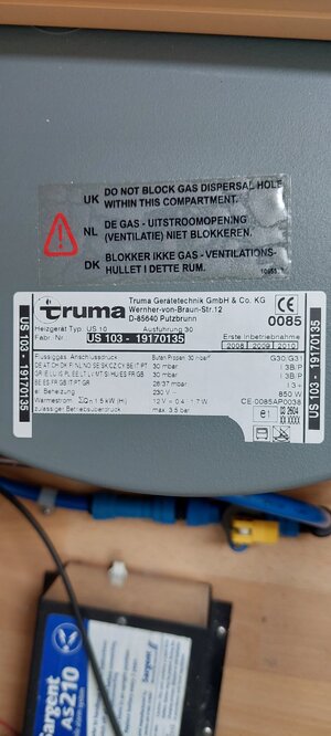

Hi I have a 2010 sterling eccles jubilee edition and the hot water is constantly scalding hot I have disconnected my gas bottle but it still gets scalding hot I have checked the fuses and they are ok is there anything else I can check before I have to get it looked at

What exact model of water heater do you have?

The product you have is a Truma Ultrastore water heater
You will a downloadable copy of the instruction manual here.
I suggest you read it and understand how to use the heater.
The gas and electric heating functions have separate controllers, so if for example the gas and electric functions are both on, and you want to turn the heater off you need to turn both the gas control panel off and the electric element switch off.
Whilst the gas side does allow you to select the storage temperature between 30 and 70C, the electric side is preset to a maximum of about 70C. So if you have both gas set to any thing less than 70, and electric element is also turned on, then the water will continue to rise to the electric elements temperature setting, regardless of the setting on the gas control panel.
Equally if you turn the gas off, but leave the electric switch still on, the water will continue to heat as long as your connected to the mains 230V ac supply.
