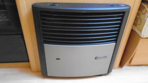

Truma fire control knob missing, where can i find a replacement please, tried numerous breakers but cant seem to get one

Hello Judith,
I have gone back through my own old service information about Truma products but I can't find any knob that looks like that. I don't think that model or option was ever sold in the UK.
Please can you confirm the model of heater, and how old it is? what make of caravan do you have?

It's the knob fitted to Truma Ultraheat blown air systems - our 2001 Bailey Pageant had one.
Try Gary at https://www.arcsystems.biz/ as he may know how to source one.

Welcome to the crazy world of caravan spares prices.
By the way - why do you think you need a replacement? I have a new one in my parts box which I bought umpteen years ago, thinking I needed it. I didn't - the fault lie elsewhere.
Perhaps Judith would like to purchase it?

Judith,
Maybe it will be better to buy a complete used heater. The knob is more than just a knob. It does a number of functions which may explain the high price!

Actually I note the original post said the knob was missing which poses questions as to the circumstances regarding its removal - so maybe a full service of the heater would be advised to ensure electrical and gas safety before bringing it back into use.
