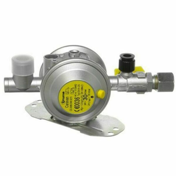

Need to get the Truma Gas Regulator No. 0129466 replaced on my 2011 Lunar Lexon. There is a number 11 marked on the old regulator. Is this the year of manufacture? If not how do I know if the replacement is this years stock.

Any Propane 30mBar regulator will do, doesn't have to be made by Truma, just make sure for ease of fitting it has the same size outlet pipe, most are 8mm.

The 11 would be the year, recommended changing at 10 years old.
Truma’s new regulator does 8/10mm
TRUMA - MONO CONTROL BULKHEAD GAS REGULATOR - 52400-01​
