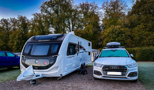

I have tried to find a photo of us in Montreuil sir Mer in France in Feb 2013 van was 2 weeks old and the snow was 2 feet deep stayed there for a month. Luckily the water supply was well lagged. . Enjoy.
22mm lagging £1.30 a metre.

I like the bike trailer behind the caravan, but I think they are illegal in the UK.
Nice looking unit.
