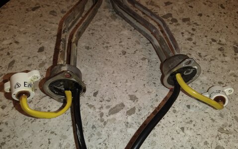

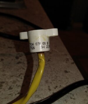

The thermostat is a simple bi-metallic switch end of . One test would be to remove and touch a hot soldering iron against active surface of the switch and measure the combined resistance ( no power on obviously) when it goes to infinity( >10M ohms ) remove the soldering iron and if possible place a thermometer ( digital with a type k thermistor or 100 Ohm Platinum resistance probe) against the active surface and note at what temperature it resets . The only simple device I know of which will reset once power is removed is a polyfuse ( basically a positive temperature coefficient thermistor ). but those are only used to protect electronic circuits from overload if incorrectly connected. The thermostat relies heavily on the mechanical construction of the switch hinge being intact and any damage/degradation may alter its characteristics . IMO replacement of the heater element assembly is the only solution, by time you have dragged the old one out and checked it , you might as well replace the assembly.If you are no good at assembling flat pack furniture you may want to call an engineer , Reassembling the cardboard cover is an artform in itself;) Here's a couple of ones which failed with earth leakage , you can see the bimetallic switch is potted as are the connections of the heater connections.If you buy a heater element off Ebay , be careful that the gasket supplied does seal the heater to the tank.

@IanB1485 I am not sure why you need to remove the cardboard, Truma put a pre punched cut out to allow access to the element . The element change can be done nice a neatly using the cut out…….unless someone just rips the ears of the stamped cut out open by hand rather than a sharp knife.

Martin _E , I agree and hopefully the OP will be able to get at the element and the screws holding it in. The location of the unit under the front seat, on most of the ones I've worked on either stopped the element being removed or on some even getting at the element and thermostat switch! I have also cleaned and replaced gas burners , which entails getting the unit out and onto the bench. The first time I did one was on my course and the outer case had already been removed and it was on a bench - easy peasy! The first one I did in the field was a real pain , I tried removing the element. it only came out half way! so out came the unit and after repairing it and doing a burner clean , Oh what fun trying to get the cover back in the correct position and the lid on. The combi 4E cover is a little better but getting the heater elements out can be worse . Truma now only sell complete heat exchanger assemblies with elements fitted.

The thermostat comes with the new element as it the thermostat wire is potted into the end of the element

An 850W Ultrastore has a resistance of 60 ohms, when cold, (I measured a few). To test the switch I attached two to an aluminium block with a thermocouple embedded just under the surface. Then by slowly warming up and then cooling the block whilst monitoring the temperature and resistance I found the switch opened at +70.6 (71.3) Deg C and closed at +61 (65) Deg C. So if yours isn't switching on until back at ambient temperature then its knackered. You could t replace the the thermostat switch with one from RS part no 222-8229
(which has a slightly bigger hysteresis of 15 Deg C). but there are two obstacles :- 1 the pitch of the mounting holes are different , 25.5 mm for the Truma and 24.0mm for the one from RS , so the holes in the RS would need opening out. 2. the RS switch isn't potted so care and extra insulation to both provide required electrical insulation is required as the RS one has 0.25" male spade connectors on it which don't provide the required protection against electric shock at 240V operation.
