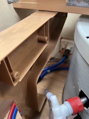

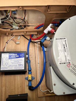

This is my system

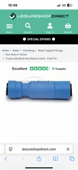

Is the 12mm blue valve by the drain down valve a non return? Thinking this could be the issue. And are the elbows on the tank also non return or not?
Thanks

Thank you for the pictures.
They confirm you have an Ultrastore.
I cant see any sign of a pressure switch to control the pump, so I'll guess the pump is controlled by micro switches in each tap. This does make a small difference, as when you are not using any water, the cold water pipe work is not held under any pressure. This means if the cold water non return valve is not working properly and it is allowing hot water to drain back into the cold supply pipe, there is no pressure in the cold system to oppose the hot water.
We must also consider that as the heater warms the water in its tank, as heats it also expands a little which compresses the small air cap at the top of the tank. this will normally ensure the hot water covers the outlet of the tank and will deliver water but air If the NRV is not holding the pressure the air cap will also expand and push the hot water out through the tanks cold inlet, and the level of the water in the tank may well drop below the tanks outlet pipe meaning it will deliver some air before hot water when a hot tap is opened.
I can see from the pictures the drain port in the blue pipe and just upstream of the drain valve there is a blue straight section which is almost certainly the NRV. Either the NRV is not locking off, or the drain valve is leaking below the caravan.

Many thanks for the informative response. I’ll change the blue NRV. Valve by the drain down valve. I’ve placed a bucket under the drain down valve to see if any water is escaping from this also but I suspect the NRV is the issue. And correct in guessing each tap has a micro switch.

Just to update the resolution to this issue. I’ve found it to be caused by a Truma Non return valve not working properly. Advice from Truma themselves was to replace the standard valve with a spring load non return valve (which I didn’t know existed!) it’s done the trick, no more spluttering hot water taps, apparently the old version were prone to letting small amounts of water to flow backwards to the aquaroll thus reducing water level in the hot water tank meaning air being pushed out of taps after being unused for a while until tank full again.
