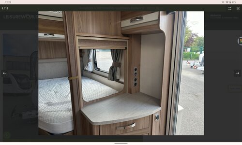

Hutch Nov 16, 2015 12,701 4,842 40,935 Jul 8, 2024 #7 I found this. Attachments Screenshot_20240708-122822.jpg 927 KB · Views: 6
D Deejuk Feb 23, 2024 90 57 635 Jul 8, 2024 #8 Looks like a pleated blind from the pic which means it will have some tabs and strings that can be adjusted to stop it falling down. Like this vid - View: https://www.youtube.com/watch?v=-hKkYghbcmM
