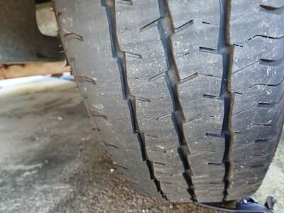

I had my caravan serviced yesterday and they noticed that one of the tyres has uneven wear. The inside edge has become somewhat smooth. This is reminiscent of tracking problems on cars. Do Caravans have similar issues?
The tyres are 5 year old according to the date code but we've only been running on them for the last 3.5 years . Probably less than 8K miles. Tread depth is 5mm.

Wear such as you have discovered on your caravan can only have a limited number of cause. The fact its appears to be very even all the way round the the edge of the tyre points to a tracking error.
I'm not aware of any adjustments that you can make on a caravan chassis for tracking, so it suggests its a component that might be damaged.
A worn wheel bearing,
bent stub axle,
damaged swing arm,
damaged/bent cross caravan torsion tube.

Interesting. Would a collapsed rubber possibly cause the issue? I am not a mechanical just going by what I have read in the past about caravan dropping on one side.

The rubber is part of the torsion tube, so yes. Anything that causes the swing arm to lose its correct alignment could cause uneven tyre wear.
Prof has pointed out all the possibilities. The remedy ,is not simple.
According to Al-ko the tracking is adjustable, at their factory!
If there is no sign of a collapsed axle nor external damage I’d buy two new tyres and see how they go
I wold swap the wheels over That will extend the set's working life, and show if the problem was tyre or chassis/axle related.

Today I went under the caravan to see if I could spot anything obvious. The suspension arms look to be in the correct position as per the chassis handbook that Dustydog posted a link to. I measured the gound to chassis distance and both sides are within a couple of mm of each other.
Hand a short lived panic when I looked at the nearside suspension and noticed a large lump of iron that wasn't on the offside. Then realised it was the bit that holds the receiver for the Alko-Secure lock. - phew. I wonder if I can remove it and save a kilo or two :)
The axle shows no sign of damage and neither does anything else I could easily see.
So, as per some suggestions I'm just going to swap the tyres around and keep an eye on things. Caravan is now having a rest before the season starts again next year. That's when I'll swap them.

OS tyre.
Furthest we venture for example is Northumberland. This entails the majority of driving through the Highlands hilly and bendy roads. Then some on dual carriageway and goodish A roads.
The roads near home are not good....potholes which are unavoidable to some extent when towing. Not always deep or sharp just bad surfaces. I know where most are so slow down.

This is something I did think about and indeed the fridge is over the OS and other stuff gets loaded on that side as well. However, the wear on the tyre is on the inside edge and if the van was leaning to towards the OS then I'd expect the wear to be on the outside edge. Well, that's my theory anyway.
