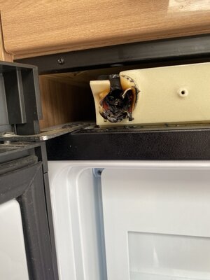

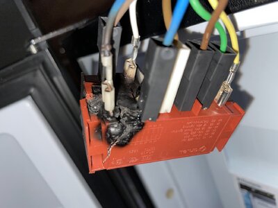

Hi I have a 2015 Bailey Unicorn S3 with a Dometic RML 9330 fridge. I had the van connected to mains power and switched the fridge to 240 to prepare for a trip next day. When I went out the following morning there was dreadful plastic burnt smell and the knob of the selector switch dropped off with the spindle burnt through. After disconnecting power and battery and with gas off I dismantled the top panel and found the switch and front fascia melted together!! I prized them apart and have now removed the switch. The 240 V terminal of the switch is completely melted out of the switch along with the terminal to the temp controller.
Has anyone any similar experience and was the cause just the switch burning out or is there a deeper problem. No other parts seem to have been overheated or burnt.
Any help appreciated.
Thanks

Wow, glad your safe, Normally problems like this have happend due to loose terminals, causing arcing and then heat melting, causing more arcing etc. A fuse in the system should have ruptured But maybe replaced at a previous time with a higher rated fuse.

With damage like that it almost impossible to identify the exact cause via a forum. It really needs hands on diagnosis. I suggest you should refer the caravan to a competent fitter to ensure the cause is traced and the damage correctly repaired.

I agree with Hutch and strong possibility of a loose connection causing the issue. You are lucky you never lost the caravan!

Thanks for the replies. I will seek advice, just trying to see if its a known problem.

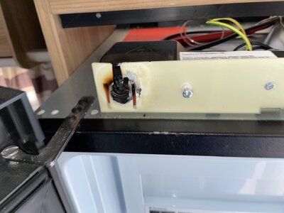

Thanks
Hi this has happened to our unicorn today. If I hadn’t come back when I did I’m not sure what I would have come back too. How did you fix this please

THe switch needs replacing, but it is also prudent to have the installation checked to see if there is another underlying cause.
