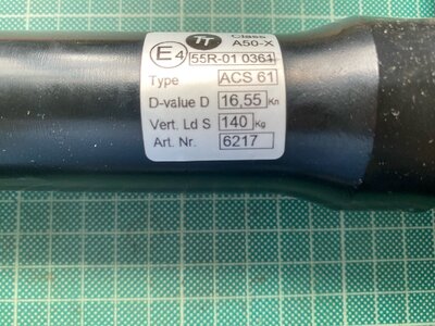

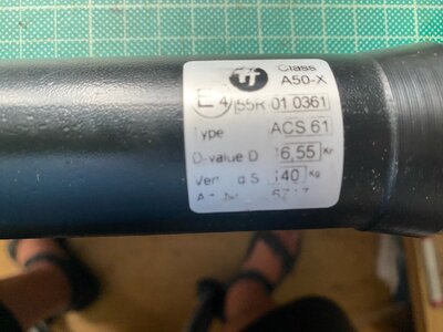

The swan neck supplied had a 4 digit code 6717, so I searched eBay and there are loads of ACS swan necks, new and used, but generally described by the vehicle application rather than the swan neck, I looked at one swan neck that was described at fitting a GLE, but it had a different part number, although looked very similar, I then looked at some Tow Trust installation instructions and found 2 different specs for the swan neck for the same year of car? , there was no joy in searching for a 6717 , so I contact Tow Trust to see why there were different part numbers and if the parts were interchangeable, I spoke to a really helpful lady at Tow Trust who explained that firstly the number doesn’t relate to a specific car, and that there would be interchangeable swan necks with different part numbers that were more related to batch production than spec change, she gave me a list of numbers that would fit my tow bar. Armed with this info I did a broader search on eBay and found a little used swan neck that was advertised for a fairly obscure car, with a low asking price, so I paid £15 for the swan neck (most are advertised at around £90-£140) . When fitted to the car the height and distance from bumper are exactly the same.

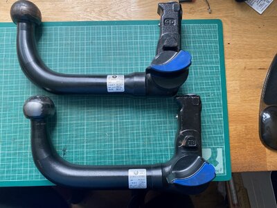

So I now have a clean swan neck for the Alko and a greasy one for everything else.

Think I would give both a thorough clean before use - looks like the lower one pictured still has oodles of original black paint on it except where the prior owners stabiliser pads abraded bits, and the top is quite rusty. In either case your stabiliser pads could be contaminated reducing effectiveness.

So I will use the new swan neck (the one with paint on) with the Alko hitch (will clean the paint off) and the other swan neck only has surface rust that wire wool will clean up, and then be treated to a traditional dollop of grease .

The advice is for Alko hitches, the towball should be bare metal free from paint oils and grease. You need to remove the paint on the ball before hitching, other wise the paint will contaminate the friction pads and reduce their effectiveness.
The balls are supplied painted principally to stop them rusting before reaching their customers.
