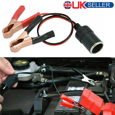

You don't need an inverter, you need a 12v DC power supply. The pump should be marked with its power requirements, it may need a 13 amp supply but I doubt it.
The easiest / cheapest way would be to remove the battery from your caravan or car and power it using one of these.
