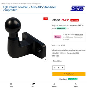

A normal mechanical Alko stabiliser requires a slightly longer necked towball. It can be fixed or detachable. The reason for the slightly longer neck is to allow adequate articulation movement between the Alko stabiliser and towball. The Alko ATC is totally separate from the stabiliser and doesn’t connect with the towball at all. It takes an electric supply from the cars socket and works by measuring caravan movement which will then activate the caravan brakes if required to control swaying.

Looks to have the slightly longer neck compatible with the Alko stabiliser. If you have any doubts check with Volvo, or did it come with a User Manual?

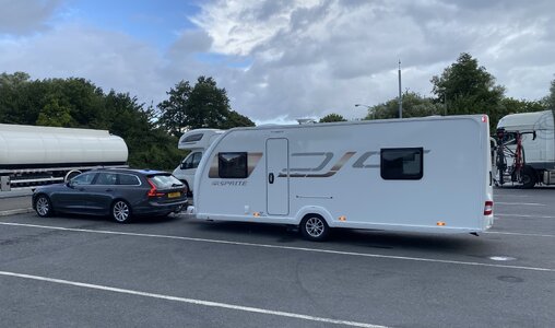

I have a factory fitted Volvo retractable towbar on my 2020 T5 XC60 identical to yours and also have the Alko ATC system on my Swift 480 Challenger. From my experience they are perfectly compatible.
