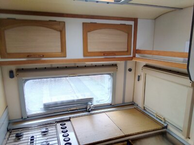

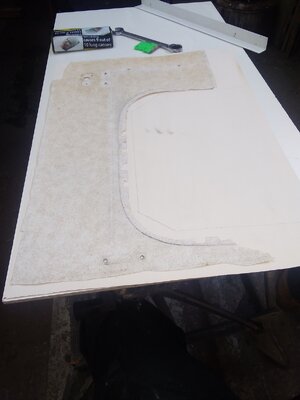

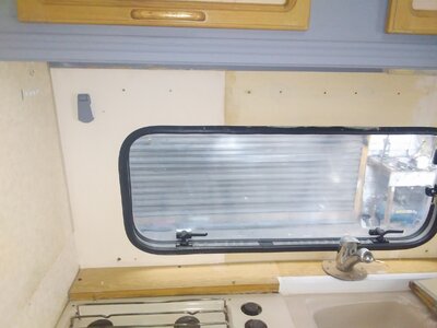

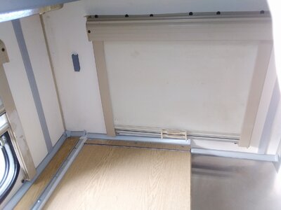

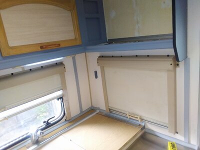

I have recently removed the wallpaper around the "gallery" section of mine,I have several images of the procedure that I took whilst doing it,,the vinyl layer peeled of leaving a thin layer of paper,taking care I was able to use the remove the vinyl layer to use as at template for rear window,the wallpaper I replaced it with is what is used in commercial premises such as offices,it is 1240mm (4 foot) wide and come on 50 metre rolls,it has a heavy duty paste applied on it plus a thinned down coat on the wall,muratec are one of the manufacturers of it,note you don't need to buy a 50metre roll, although my son doe's when he is building offices. VM I will put some images on shortly,,, Gary
