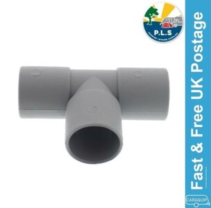

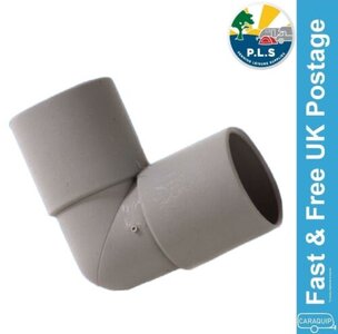

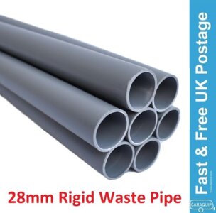

All of these are readily available on eBay, or most decent caravan dealers. Note the solid pipes are 28 mm whilst the convoluted are 28.5 mm. Check the size of couplings. They vary between male and female and solid to convoluted.
