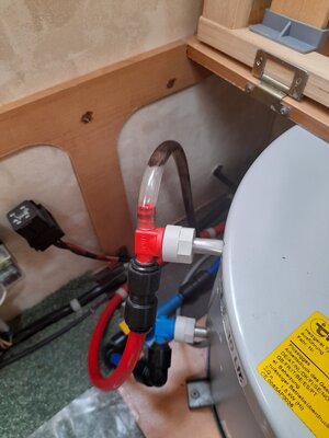

Hello,
I have had an Abbey 215 GTS Vogue since Sunday. I can not get the shower to work. I've done the whole thing of making sure the value is horizontal, and turned the hot water taps on until they stop spluttering. I noticed that my aqua roll was simply just quickly draining it's 40 litters and making a mess outside the van. I have just noticed that there is what appears to be a drainage pipe a little behind the inlet. This was just pouring water out. It's not the usual drain pipe to empty the heater. I know this as I lifted the valve to drain and it all pured from a different pipe.
The one I do not know about appears to be some kind of overflow pip that is attached to the red pipe that comes out of the heater and towards the back of the van and the kitchen and bathroom area.
What crazy devils work is this?

Without the name/model of the heater and some photos it's hard to say for certain
Could it be the hot water pipe has come adrift of has a hole? or some safety system to stop over pressurisation?

......the red pipe in your photo is the hot water supply pipe to the hot taps and shower. The red union with an attached translucent pipe that exits beneath the caravan is an overpressure relief valve.
These can fail due to age.
Truma supply a kit for replacement.
See here

What size/type of non-return water valve am I looking for here? Possibly a MRK 1 / MRK 11 Carver Truma Ultrastore system. Can anybody else see something that may be interesting? Still only day 5 of my first campervan ownership.

Is not possible to buy a suitable joint / piece of pipe to connect to Bill’s suggestion? Merely plumbing?
19,133
4,331
A new non-return valve was bought for the pressure over flow pip and new pipe as the old one was just dirty and horrible. Now have pressure in the shower and plentiful hot water. Thanks for the advice.
You haven't told us if you have used a genuine Truma part , you have simple described a NRV, which does not cover all the functions of the Truma part.
The genuine Truma part serves three functions. Its a non return valve, it's a drain vent, and most important of all its a pressure relief valve. If you haven't used the correct part, then you could endanger yourself especially if the unit does not have the correct Pressure Relief valve which is an essential safety requirement.

I'm not going to sugar coat a concern I have about safety. It's better to advise before a problem arises if it can be avoided.
In this case we know, the OP has replaced a faulty part with a "Non Return Valve" If it was the heaters drain/NRV and Pressure relief valve , then simply replacing it with an NRV is not sufficient to ensure the safety of the appliance, in fact as I pointed out it makes the appliance more dangerous.
