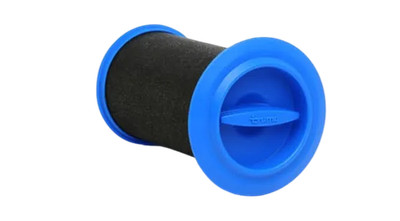

Is it this type that is found externally in the water inlet housing beneath the threaded cap?
This seller advises fitting new at the start of the season and then about every 35 days thereafter - although I suspect that nobody changes as frequently.

no its not one of those ive seen videos on how to change those but i dont have one on the outside of caravan

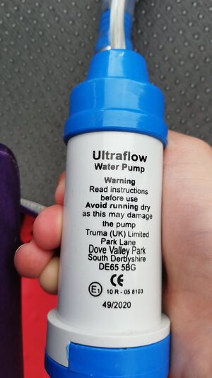

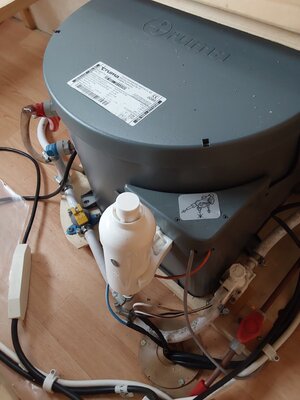

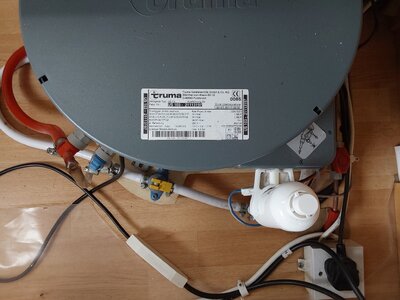

To help clear up my earlier question on does my truma system have a filter that needs to be removed I have attached 2 x photos.If anyone can clarify if this has or doesnt have a filter i would be most appreciated

The bailey ranger gt60 2010 had no filter . The water pump is a submersible fitted I. The aquaroll. The only filter you are likely to find will be the mesh gauze at the end of each tap. Puri lean and Milton Solution work well for me.
