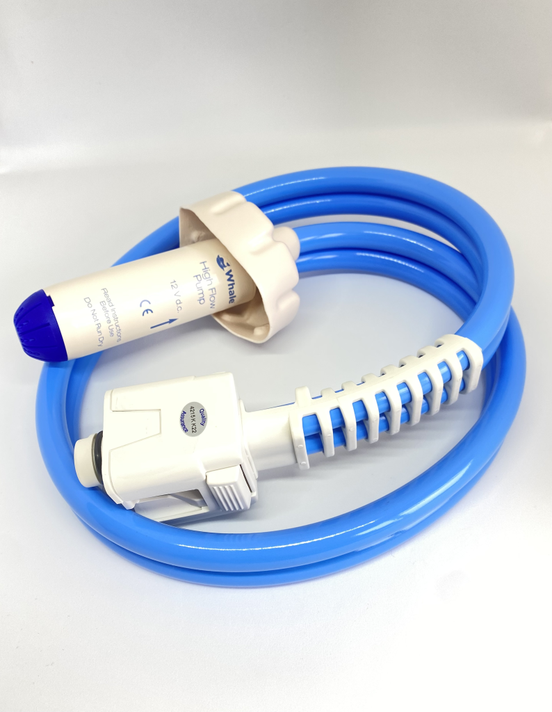

I need this type of connection but without the 12v pump and plug πŸ‘

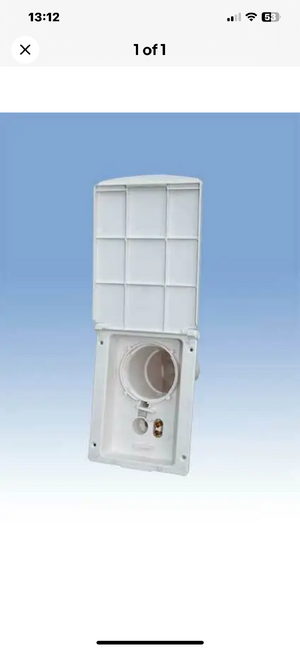

Hi this is what I have
1,644
641
Looking at your picture it shows the electric connectors so that fitting used an external pump originally, as you say your pump is now in board, is that a change you have made or a previous owner? If you still want to replace the water inlet, I suggest you measure the original and then check the size against a new Truma or Whale inlet, without the electrics, it would be a bonus if the screw holes line up, but not a deal breaker. If you can find a suitable replacement, you need to remove the old one, clean every bit of old sealant off the van,and either fit the new one using Silkaflex or similar, although Truma do a sticky foam gasket to fit their inlet, if you are lucky the water pipe connector inside the van will be a push fit onto the new inlet.

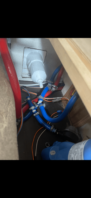

This is setup inside πŸ‘ sorry short reply’s doing this off my phone
1,644
641
Thanks for the pictures in 5386 it looks as though the blue pipe that is disconnected should push straight on to the back of your new wall fitting and then attach with the jubilee clip, also looks as though the blown air ducting is disconnected, good luck let us know how you get on

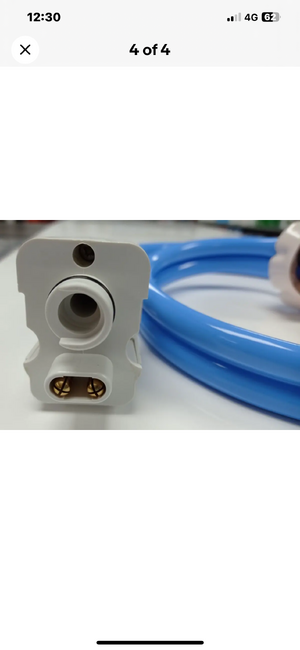

hi the pipe is disconnected because im changing the old inlet filter housing i just need to find a connection that is able to just have 1 pipe and no external pump,one like this one would work
1,644
641
You need to look for either Truma or Whale inlet they wil both come with a single pipe connector and nothing else, with the Truma you will need one of the connectors, which will have the built in O rings to form a seal, can't speak for the Whale one as I changed my Truma recently,after the external flap broke.
That inlet on caravan is dual input. Bottom terminals and hose connection are same as mine which is for external pump. I have same pump fitting on my caravan, uses those to padddles to hold it in place..
Large hole at top looks like hose inlet for onboard pump. My inlet doesn't have that as there no onboard pump.
FInd name of hose inlet and you are half way there to googling correct part. Given pump connection is now obsolete you may struggle to source hose fitting if they didn't carry the design over.
