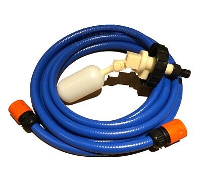

You can buy one like the link, either with flat hose or normal hose (food grade) and probably worth getting 10 mtr length, and to pack and store neatly I use a mains lead storage bag:
The float is screwed in to replace the side filler cap on the aquaroll (or other make) so as the water is used the float allows it to be refilled, just like a water tank ballcock at home.

We always carry 10 metre hose kit Caravan Mains Water Adaptor Aquaroll a mains water kit to fit a 40 ltr (Also take a extra 10metre hose just case) Hose Joiner male to male We always book Hardstanding Service Pitch .
