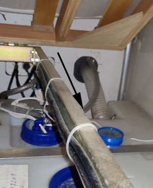

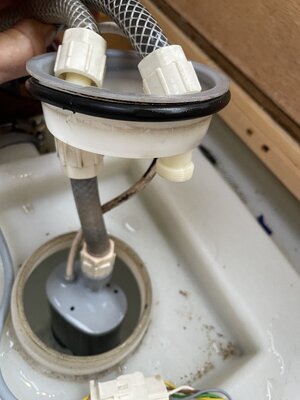

Hi,
Fixing up an old van and the water is hardly coming out of the kitchen sink and nothing out of the shower. The pump is working, I can hear it. There seems to be a missing hose inside the water tank, there is the main one that draws the water but it looks like there is a place for another as there is a line running from the outside of the tank somewhere. As you can tell I am a newbee so any help trying to figure out why no water or how to remedy appreciated!

Did you see the photo? What is that missing pipe going into the tank?

Is that pipe NOT the fill pipe for the tank, or does that go in at a different point.

No that s not the fill pipe. As you can see it is similiar in size to the one pipe coming into the tankl.

MAy I suggest you follow the unknown pipe and tell us or better take a photo to show where it goes and what it connects to.

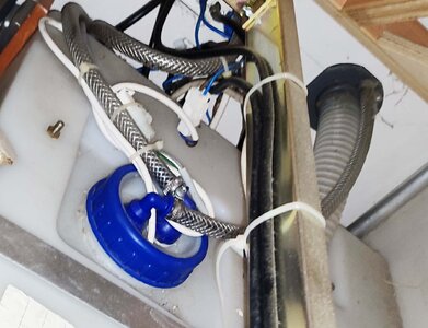

The second connection on our Hymer, is the air vent pipe associated with the tank filling tube.
Therefore it terminates at the cap, there is no internal pipe fitted to it.
Apologies for the poor quality image, I was holding a heavy bed up whilst using phone.
19,233
4,405
Following JTQ's post, the pipes purpose jumped out at me. It is as he describes a breather pipe, to allow the water level in the tank to change without causing a pressure increase or decrease in the inboard tank.
