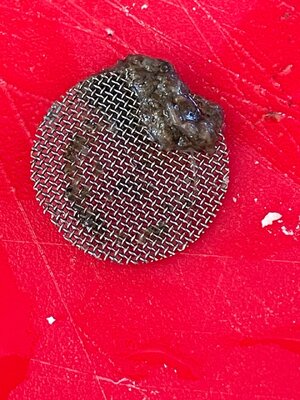

When you see this stuff lurking in your pipes you have to ask: are you feeling lucky?
