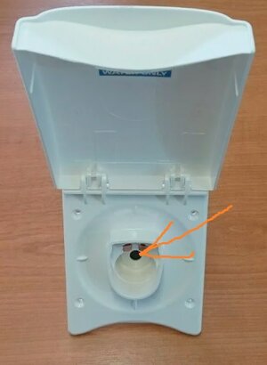

From your last post I take its just coming out of the inlet , or is it the trigger , if it's the inlet , then the no-return valve rubber may be stuck, I've come across this before , to check this gently press the black seal in the attached photo with a round rod ( not pointed) to check it opens . If OK then check the housing for cracks around it , again I've had a 'hamfisted' customer who managed to crack the surround ( the Truma system is notorious for being 'stiff' unless kept lubricated and some people hate the system and prefer Whale).

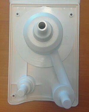

On the dual inlet Trumas I've seen the unused RH connector(When looking at the front ) inlet is a blank see photo, but doesn't go through the filter and doesn't have the electrical connectors on for the external pump., however someone could have modified it. A short video of the offending 'gushing' will give everyone a better idea of the problem.
