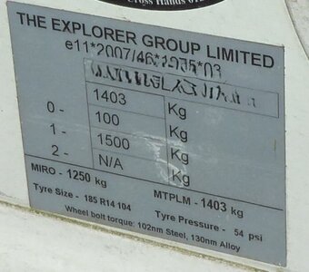

Hi
Just about to register for the new required trailer plate and when checking the caravan slightly confused.
The plate has
MIRO 1250 Kg (Mass in running order - empty caravan)
MTPLM 1403 Kg (max permissable weight)
Then also on the plate
0- 100 Kg
1 - 1500 Kg
2 - N/A
So is the gross weight allowed 1500 Kg and not the 1403 Kg?

0 - 100Kg is the max weight on the jockey wheel (and possibly hitch).
1 - 1500Kg is the max weight the main axle.
MTPLM is the maximum total mass of the van when being towed.
There was another thread on registering the trailer. Is it actually needed for a private caravan being towed by a non-commercial vehicle?
I think it might help to clarify this just a little. MTPLM (Maximum Technically Permitted Laden Mass) is the NCC's theoretical mass limit for the whole caravan. You have to weigh the complete caravan on its own uncoupled from the car to be able to check your caravan has not exceeded its MTPLM.
Sum of load on road wheels plus the load on the jockey wheel must be no greater than the trailers MTPLM.

The NCC‘s theoretical mass limit is not the MTPLM. The actual MTPLM is what is displayed on the statutory plate (if the caravan was built after implementation of whole vehicle type approval in 2014). Foreign authorities will only go by what is internationally understood and that’s the statutory plate, not anything that the NCC concocted.
In the OP‘s case, the two values happen to be the same, (probably because the NCC details and the statutory plate have been combined in the same sticker - something that I believe only the Explorer Group does), but that will not always be so.
