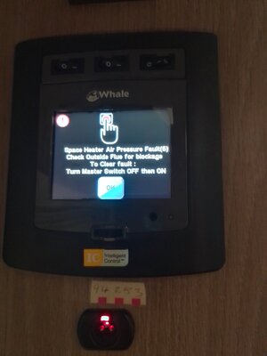

Hi whale heater not working I check flues and done reseat noting happening what else can I try

I only run on electric and have had this fault on a few occations when there is a high wind, or the wind is blowing in the "wrong" direction ie up the exhaust pipe.
I have a work around to place my aquaroll near the exhaust to shelter it from the wind. Turn off everything at master switch and restart everything.

There are reset buttons for the heating and hot water on the actual Whale heater under the front bench. Two buttons, one for heating one for hot water. Try pressing those. Check your manual for locations.
We had a similar problem when there was a strong wind blowing into the outlet. Like Bluetonic said a barrier that does not block the exhaust but does shelter it from the wind was helpful.
