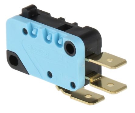

I think it is a V3 micro switch
RS components £3.89 as to if you can actually change the switch I don't know, I would try removing old one first.

Thanks for all your help guys. ericmarks, the connector look like the part I need.
I have ordered this so see how it goes. if it doesn't fit then I will just need to get a new whale pressure switch.
Sorry mate , totally different , microswitch,.
