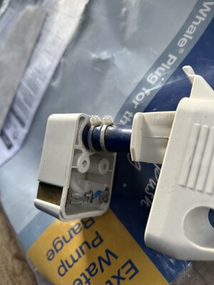

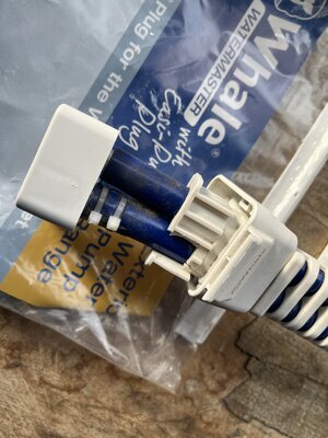

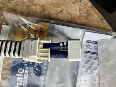

The common problem, as per Roger L’s post, is the pipe coming loose.
IMG_2903.jpegIMG_2902.jpegIf you can take the inlet fitting apart (the screws are buried deep) a couple of Ty-wraps will keep the pipe secure. You will have to take a stanley knife (or similar) to the pipe support to make clearance for the cable ties. One of my spares now - current ‘van has an onboard pump.
