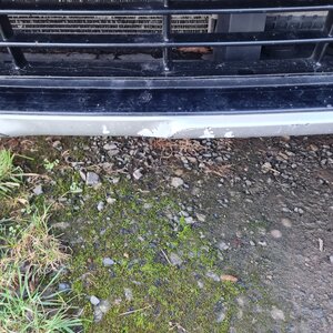

Plastic front trim, Kia sportage 18 plate. What kind of paint will l need to touch this up? Many thanks.

I'm not bothered about matching as I would be doing the full length, just what sort of paint I.e. airfix, acrylic, plastic paint etc.

Just go to Halfords or an auto factor and buy some. I’d prime it first using a primer even though you are painting on to a painted surface. Gives better adhesion.

Use an epoxy primer, now available in a 2-part aerosol can. Scuff the plastic well first and then overcoat it within 24 hours from memory. Epoxy primers are fantastic as they have excellent adhesion to most materials, they flex and they're waterproof.
