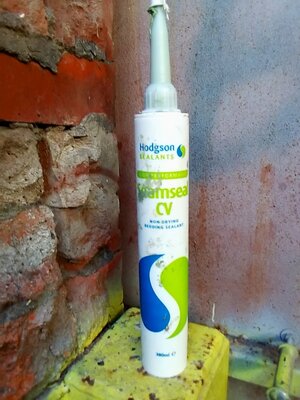

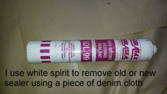

HODGSON SEALER_011854.JPGBoth these sealers are bitumastic.I replaced all the Herzim with new,it went in no problem,, Always allow extra overhang to allow it to shrink back before a final trim
