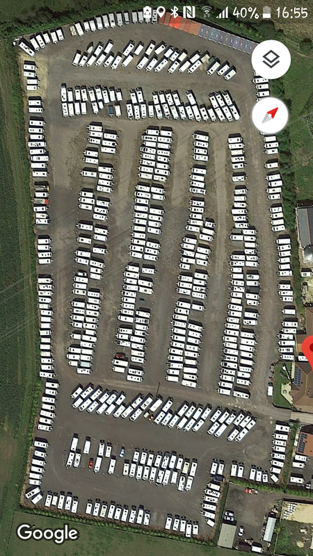

We don't cover ours as we are away every for 5 weeks but ours is situated in a storage facility where there is only about 4 foot gap as you can see between each caravan so not really in direct sunlight all the time unless you got and end spot which we haven't .
Mine's the white one !! :p

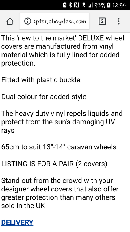

I have some twin axle wheel covers by Milenco, which fit fine, but the elasticated strap supposed to hold it in place is feeble and gave up within a few weeks. They are also quite tight to fit as you have to reach under any wheel arch spat to the inside of the wheel to manoeuvre into place. Still to figure out a simple retention method.
Oct 12, 2013
3,037
Tempted now since reading the last few posts ! I've just been looking at them on Amazon and I can get them to match my colour graphics on my van , set off 2 for £13.oo . ;)
