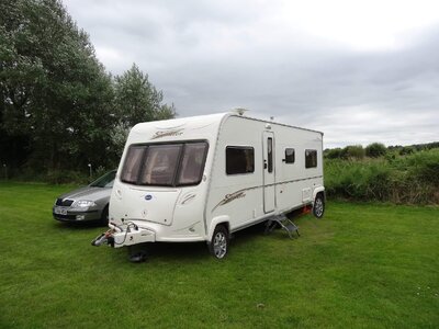

When we had our twin axle I measured the height of the car's tow ball unhitched and used a noseweight gauge at that height. I don't know how accurate that was but in the four years we had it it towed perfectly and I concentrated on the enjoyment of using it rather than overly worrying about anything else.
It won't have been absolutely accurate as the towball will (usually) drop slightly when the noseweight is applied - but as upthread, the difference isn't enough to worry about.
