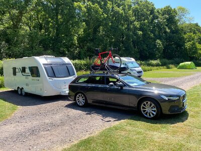

A bit of thread drift I suppose, but OUR twin/single axle experience:
I have been towing large trailers since the age of 17 (37 years ago!) and caravans for 27 years so plenty of towing and manoeuvring experience. All caravans were large single axles until 2018.
A growing daughter wanting more space saw us switch to a new Swift Sprite Quattro EB in March 2018, towed initially with a 2016 BMW520D followed by a 2018 Volvo V90 then a 2022 Volvo V90. Facts & figures for those interested:
Weight ratio versus car kerb weight was 92% for the BMW and 86% for the V90’s against the Swift factory MTPLM of 1624kgs that I eventually upgraded to 1800kgs.
Price of the caravan was £19,150, around £2,500 dearer than an equivalent single axle. Current list price of a similar model is around £27,950.
Fuel economy of the current V90 towing: 23mpg with the twin axle and 26mpg with the current single axle.
We liked the space of the twin axle but found some CL’s tight with it, servicing expensive, it needed four new tyres and with our daughter at University we decided to downsize. It’s true that some twin axles are expensive heavyweights needing a huge tow vehicle but the above shows it doesn’t have to be that way.IMG_6145.jpeg
When you get down to it, it's a matter of personal preference based on one's own priorities. My single axle caravan is almost a foot longer than the twin pictured above and I would never change to a twin.
Again it's just a matter purely of opinion and aesthetics but a very large 'van somehow looks 'wrong' balanced on a single axle, whereas on a twin like the Sprite above it looks 'right'.
