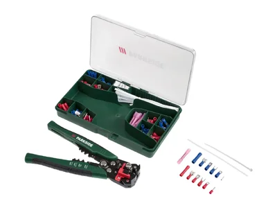

Picked up a wire stripper/crimping tool.How good it performs and lasts remains to be seen,it comes complete with a good complement of fittings,The great let down is the case, it's a complete joke,unless you have 1mm dia fingers to get the fittings out, I'm not really bothered myself as the will be transferred into another case, expect to experience difficulty.If all works well 8/10
Sorry to rain on your parade but if it's this one:
Then the strippers are good but the crimp part of the tool is rubbish.

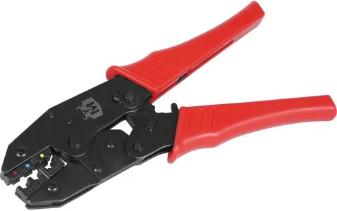

To get a decent joint with a crimp it's best to use a ratchet crimper like this:

I will keep using my Cembre crimp tool for crimping when needed.
The most important thing with crimps is to use the correct size cable for the crimp, otherwise the connection won't be reliable, I realise this sounds obvious, but I have seen quite a few failures on classic cars, normally where the crimp is too large for the cable.
