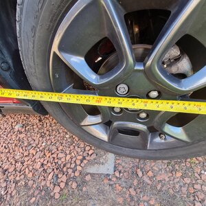

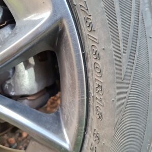

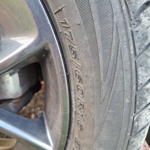

Just to confirm , the wheel in question is a suzuki, not kia, subaru etc. If you want to know about different wheel rotation start your own thread and stop hijacking mine. Thanks to the ops, for genuine replies.

Spare wheel holding thingy wasn't quite long enough, they want about 20 sheets for one with longer threaded bolt,no way! Went to my local agri parts place and for the pricely sum of 58p got the bolt and joining thingy , Job done. 20250825_132307.jpg20250825_132251.jpg20250825_132208.jpg
