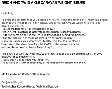

An observation on the use of the Reich for twin-axle caravans - the device itself has thickness, up to 45mm according to the internet - so the measured wheel will be higher than the other wheel on that side which will distort the readings and equally distort the reading when the other wheel is weighted.
So you need to arrange planks either side of the device so that the other wheel is at the same height as the wheel being measured - to be really pedantic you need the same thickness planks on the other side to prevent the tilt of the caravan affecting the reading.

Lifting one wheel by 45mm will increase the weight on that wheel and reduce the weight on the other wheel that side - caravan springs are very high rate, in terms of kg per mm, because the movement range between no load and full load is relatively small, much smaller than a car - that 45 mm is around half the total movement so could have a major effect on the meaasurement.

CoG doesn't need to move - the weight is transferred to the wheel being weighed, increasing it's apparent load - and the weight is then transferred to the other wheel when that is weighed, increasing it's apparent load.
The overall weight doesn't change, it can't - but the wheel load is measured separately with weight transfer in between.
It's faulty logic to weigh one wheel at a time unless the other wheel is blocked up to the same height.

You can shift wheel load on a twin axle from one to the other without altering the CoG.
For example, assume the spring rates are 10 kg per mm and that the front wheel is on a 20mm block while the rear wheel is in a 20mm hole so the caravan is level across the axles - the load on the front wheel will increase by 20 x 10 = 200 kg and the load on the rear wheel will decrease by the same - any measurement of the front wheel will be 200 kg more than normal - if you then change the configuration so the rear is higher while it's being measured it will equally read too high - thus adding the two figures together will overstate the total weight on that side of the caravan.
The only way to use the Reich accurately is to make up planks to match the height of the Reich measuring pad.
I think my assumed spring rates and wheel deflection are of similar order to Saxo Appeal's testing and that his computed weight is over-stated significantly.

Yeh thinking the same mate,
I’ve actually just been enquiring with some more public weigh bridge business near me
Aug 5, 2023
682
286
2,135
So due to the above, the calculation is much higher than it seems due to the spring pushing down on the Reich with more force then what it would be due to compression, think I’m reading that correct.
9,443
3,928
So due to the above, the calculation is much higher than it seems due to the spring pushing down on the Reich with more force then what it would be due ti compression, think I’m reading that correct.
That's Reich confirming what I was trying to suggest - it'll be interesting to see what it brings your weights down to.

If the overall height is 45mm the load cell (the bit the wheel sits on) appears to be around half that. I'm confident that raising one wheel (on a twin) will increase the load on that wheel but I have no idea by how much. I'd speculate that it will vary from caravan to caravan depending on chassis, suspension and weight.
