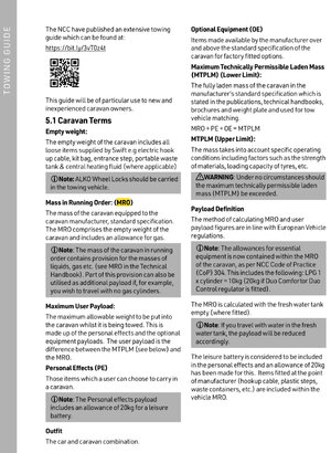

The Gas Bottle, battery and spare wheel is all included in the MIRO is it not, pretty sure I read that in the Swift manual.
What do you think of my thoughts on the Reich calculating both wheels, surely it’s including a portion of the same weight calculated on the first weighed wheel?
Yes we will be going to a weigh bridge again just for a second opinion, but makes me think whether to keep the Reich or not…as someone said earlier, there wasn’t even a calibration cert with it..

If I understand it correctly, the MRO includes both Gas and personal effects of 20kg for the battery
This will be included in the 1683kg 🤔

I just wonder if the spare wheel is also included in the MRO, as this was added at factory , and if going to those extents, the microwave, the fridge etc 😂

It clearly states that the battery is not included in the MIRO of the caravan. It is part of your personal payload. Battery would weigh about 26kgs.
Our MTPLM is 2000kg. We have AWD motor mover, a satellite dish, air con and the ALDE Continuous hot water supply fitted. We carry 2 TVs, two chairs, pots, cutlery and crockery in the caravan plus we fit a front towing cover.
We do not and have never carried awning, poles, food and clothes in the caravan. We are at about 2000kg. Even if that Reich is out by 5% you are still over weight and need to carry more in the car.

What is personal effects payload allowance, why would they state ‘allowance’ why not state Battery is not part of the factory 1683kg ? And I presume the spare wheel is included in the 1683 as this was fitted at factory?
If your payload is 150kg then you need to deduct the 26kg for the battery from that payload.

Can anyone confirm if the spare tyre is also included in the MIRO, presume so as it’s fitted in factory
Depends whether it's within the standard specification for your model or whether it's an extra cost item - the former will be within the MIRO but the latter won't.
