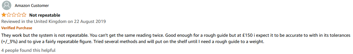

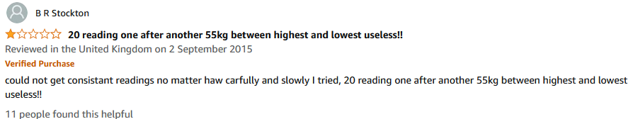

There was a website called 'Berger Online' and the Reich was cheap, but looking at their reviews put me right off
I felt the same when I read the reviews😱
