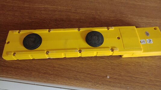

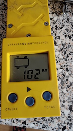

Mine does single and twin axle, and just 4 wheels, ie car or motor home, with single wheels.
The yellow one weighs Upto 1000kg per wheel, The Orange one weighs Upto 1500kg per wheel.

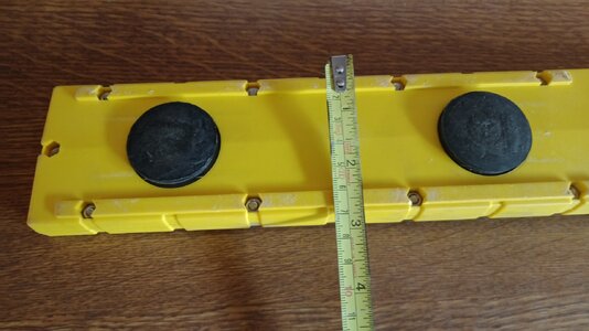

The Reich units (Orange and Yellow) are about 2cm thick so each wheel is lifted by that amount as you roll over the unit. That will cause the the vehicles Center of Gravity to move away by a small amount from the wheel being weighed, and that means the unit will show a slightly lower value. To remove this error if the other wheel on the axle is driven over a piece of 2cm wood so both wheel are raised by the same amount at the same time the error will be reduced to an insignificant amount
Both units have various operating modes which can handle a range of tow vehicles, trailers and camper vans, and can give a totalled up result, but the reality is its only simple addition, and to find the true nose load a straight forward subtraction.
The chances are the Reich units will be more than accurate enough to give you the answers you need.
