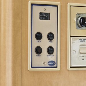

Hi I'm new here, I have a 2006 Bailey pageant, My water pump keeps stopping working, the light on the switch beside Master keeps going off I have Checked Fuse and loose connections
Any ideas be greatly appreciated

I had a Series 5 Bordeaux. Lovely caravan. It could be the adjustable pressure switch needs readjusting. If you have the Owners Manual the procedure is detailed. Very simple no special tools required.

My Pageant Series 5 Vendee had the submersible pump in the aquaroll. Non adjustable. Over the three years I had two replacement pumps. In fact we carried a spare !
If yours is a submersible I suggest you try it in someone else’s or buy a new one . They don’t always blow a fuse when they fail. How old is your pump?

If it is a submersible pump, normally the contacts at the caravan wall is the problem, a clean with a nail emery board, Steal it from your wife or partner, and try again. Over 15 years I have replaced one Truma pump and now use a whale pump on the Truma connector to my Coachman at least every trip I have to " Wiggle " the connector to make the electrical connection.
Always carry a spare pump and hose unit.
