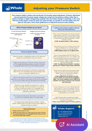

The "intelligent" pressure switch ( yellow module) has a habit of failing. Mine went on site as I was setting up. If you can find the parts it's just a question of removing the yellow module and fitting the adjustment screw and lock ring. Then setting it as in the picture enclosed.
I ended up swapping the whole inlet as I couldn't get the parts easily.
Thanks for that
Took it to bits and it had shorted out
