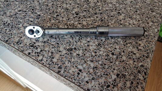

I suppose this would do as it measures from 2nm.

If your son is talking about this type of torque wrench, then yes they are fine. Myself I prefer " hand tight" but that's with over 55 years of hands on working on engines and aircraft.
Torque wrench
Torque wrench

Thanks, my grandson now has the bars and he’s going to Halfords to buy a similar preset torque wrench at 5nm from the bicycle department. I do mine up hand tight with a screwdriver and a 10mm socket fitted. Difference I guess between an engineer or someone well versed in cars, motorbikes, etc and someone who isn’t. But better he, cautious than over confident. I don’t want my roof box spilling out over the A1.
