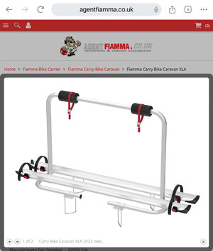

Has anyone any experience of fitting/using the A frame bike racks onto Bailey unicorn ? (1 adult lightweight city bike - Bailey unicorn Madrid, 2016)
Have changed my car and it is unfortunately now an either/or option between carrying bikes on the back or towing 😞 - can’t do both at the same time.
Bike is too big to go in the car, I’m not tall enough & shoulder injury precludes it to go on the roof . Don’t want it inside the ‘van and it can’t go on the back.
The a frame seems the only option:
https://www.agentfiamma.co.uk/fiamma-carry-bike-caravan-xl-a.html

The first thing needed is to remove A frame cover and see if there are any existing holes for fixing that mate up with the carrier, as drilling the frame is a NO. Then consider the weight of the rack plus bike weight added to the towball permitted noseweight. Also will it foul the handbrake operation when a Bike is fitted.
Apr 8, 2019
47
27
10,535
I’ve fitted this carrier to a previous van. No drilling is required other than through the a frame cover if you choose not to remove it (I did)
Weights are well within limits - already checked.
It’s the fouling the handbrake, jockey wheel and other issues I’m after information on, hence posting here.
